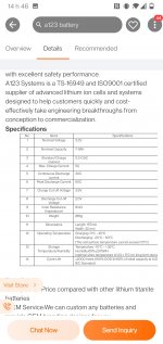

Hey guys I found this A123 32157. I talk with Alex and he found a good deal on ebay of cheap A123 26650 with good specs and I want to go with it for a good moment now. The specs of the 26650 is about 70A continuous Discharge and 120A in pulse.. I want to have a set up of probably 15s5p so 48v with 350A. The problem is the 75cells that I need to spot weld with copper/nickel strip but im not a big fan of it.. and I found this! Little bit biger in diameter and little bit more then 2x longer BUT a lot more power 210A continuous its going to be pretty much the same battery size but lot less cells and the cells going to be screw and not spot weld !
Wath do you think?
View attachment 309View attachment 310
