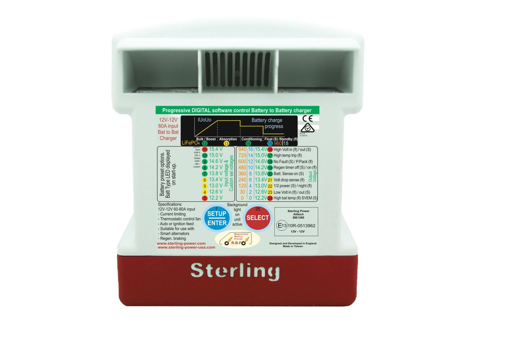

Firstly we need to understand that "BMS" does not mean a "Charger". A charger is typically an independent device to the "BMS"
Typically the Job of a BMS is to monitor the voltage of a complete pack of cells and ensure that no individual cell goes out of the predefined range.. If the voltage of a cell goes to high due to charging or to low due to discharging then the battery will be disconnected from the Motor or Charger to prevent catastrophic damage to the battery. In this example below these thresholds are customizable.
As part of the "BMS" it's typical for it to "Balance" the pack of cells. It will detect a variance in individual voltages between the cells and try to equal them all out so all the cells are the same voltage.. This is typically done via a resistive load added to the cells displaying higher voltages like the one below, but it can also be done with an "Active" balance that takes some change from the higher voltage cells and gives it to the lower voltage cells.. This is far less wasteful than a resistive Balancer.
It's important to add that you can get Balancers independent of a more complex BMS.
Some chargers have balancers as part of the chargers. This is the case when it's not expected for there to be a BMS in place.. Like in RC applications.
