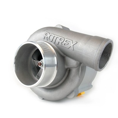

so ... to get rid of coupling / bearing / oiling (and many other electrical) problems time to approach it all differently:
a rotrex unit with built in 9.5:1 "gearing" and seperate special oiling loop like e.g.
(@AlexLTDLX with his sledgehammer engine would need a bigger unit)
with the right belt drive pulley ... and
a golf cart battery / controller / motor combo
looks like a viable solution!
standard 48V components , standard controllers (much cheaper than the crazy RC stuff), robust slower turning torquey motors ... (tons of aftermarket ... far east and domestic)
and no direct coupling acrobatics!
a smart mounting plate to accomodate the rotrex unit, a small belt tensioner, a motor and 2 pulleys (with the right ratios to hit the rpm band) should make it still compact.
(now looking into a good used cheap golf cart to strip, LOL)
