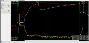

So, based on the graphs above, I'd think that the first pass saw more voltage (less sag due to having 2x 16s packs in parallel), and should've seen more current and wattage. But that's not the case, according to the ESC datalogs.
Let's first compare the eRPM (and actual impeller RPM of the compressor - to get impeller RPM, simply divide eRPM by the number of pole pairs in the motor - in this case, it's a 6 pole motor, so there are 3 pole pairs - so divide eRPM by 3 to get impeller RPM).
1st pass:

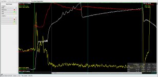

2nd pass:
You can see that the impeller was spinning faster throughout the runs in the first pass; in fact a lot more of the second pass was under 80,000 eRPM - 80,000 eRPM being 26,667 impeller RPM. Which makes sense, when you look on the right hand side of the datalog screen shots under "Minimums," you can see the first pass had a voltage minimum of 50.6 volts and the second pass (with the disconnected pack) had a voltage minimum of 48.31 volts. So far, it all makes sense, right?
Here's where it gets bit odd. Look under the "Maximums" area on each datalog - the 2nd pass where we saw less boost and impeller speed was actually pulling more current - A LOT more current - 285.72 amps vs 241.09 amps for the first pass. And wattage follows suit - 13,802 watts for the second, less boost pass, vs 13,157 for the first, more boost pass.
So now the question comes, why is that? I'd think the first pass would've pulled more current and therefore wattage as well.

While at first glance, they seem to be pretty close, if you look carefully, you'll notice the duty cycle on the second pass is on average higher than the first pass.
Now here's where I'm starting to guess, and other theories/inputs are appreciated. It seems that the closer we get to 100% duty cycle, the more power the motor will draw - it's getting less efficient. And the conclusion I'm drawing is that more voltage buys more "headroom" as you close in on 100% duty cycle. SO... I'm gonna run with the notion that even more voltage (which I'm pretty sure my new battery pack will provide), will give us even more impeller RPM, and therefore boost and power, all while drawing less current. Of course all of this is "up to a point" but we don't know what that point is yet. But we'll probably find out soon enough.
